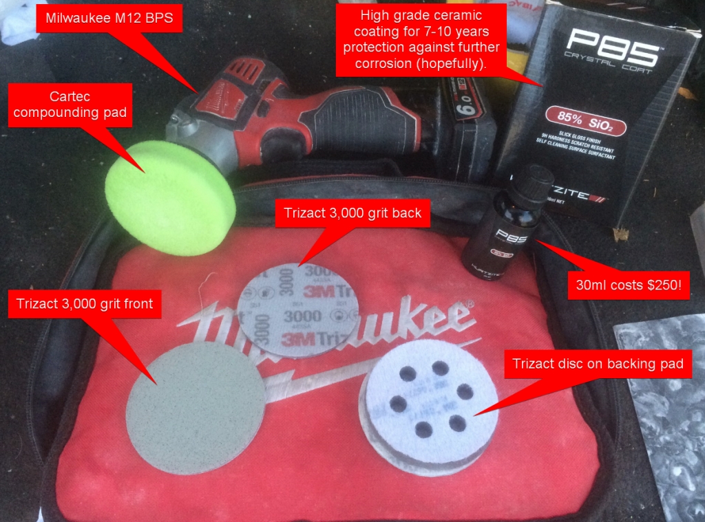

New delivery of my K7. First job...make her purdy-er. Starting with the paint (I'll get to the forks later - look away - oh the horror). I restore and polish headlights for a living so I decided to use the same method except without the hard sanding. I started with a wash and clay bar, then rubbed it all down with a 3,000 trizact 3 inch disc (by hand), then 3,000 Cartec compound on a 3" rotary polisher (good for small polishing jobs like headlights and tanks) followed by a 12,000 Cartec finishing polish and finally X-Wax by Meguire's. Not 100% show quality perfect but pretty good I reckon. The photos show how the bike arrived (with 3 year old dust still on it) and after the polish.
Here's a video showing the before (after wet sanding) and a small section that I finished to show the difference. If you're scared to wet sand, get a 3,000 trizact disc from your local automotive paint supplies and have at it. It's very mild and removes a lot of small scratches.

Super simple, just do it by hand, that's what I did. I only used the polisher (Milwaukee M12 BPS) for the compounding and polishing. Its just very accurate sand"paper" except on a fabric backing and computer generated exact grit that doesn't clump (as some of the cheaper brands can do) causing deep scratches. Cleanliness is extremely important as always but it'll be just like sanding. You can use the disc raw or with a backing pad like I do for a better grip, to take the finger tracks out of the equation and to make it easier to handle. I'll go out and take a picture of it and post below. Walking the doggo at the moment.

Yeah, luckily I use P85 Crystal Coating (85% SiO2) in my business so I have some lying around. You only need a few drops but I'm keen to see if it's a possible solution to the problem I read a lot of people are having in here and that's constant polishing. I use this stuff to prevent headlights from going yellow after I restore them and it really works so I'm guessing it might also work on metal. We shall find out. Happy to be the guinea pig on this.
