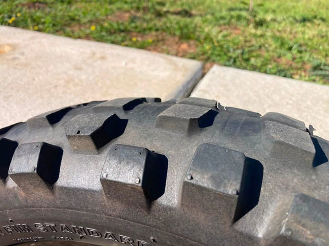

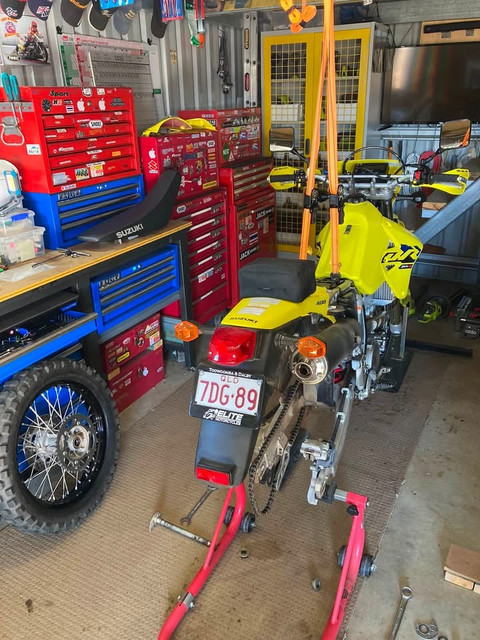

Another 109K's this morning. I like the knobbly tyres but the bitumen and gravel roads chew them up.  All done for at 2,803K's.  I can fit a long lasting better road one, but I'll be stuck in the mud somewhere.
Might try a Dunlop 606 next.

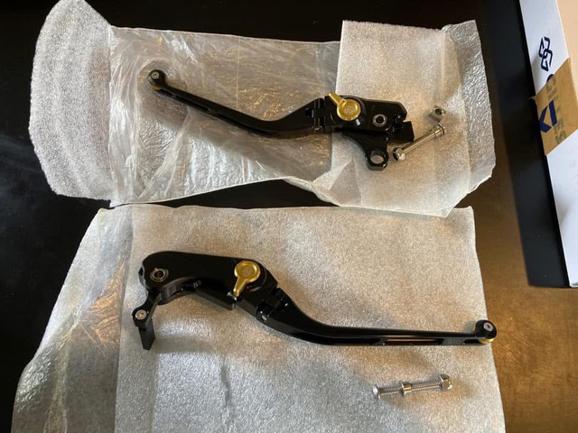

First small test run with new clutch and brake levers.
Reason I replaced them is the excessive vertical play at the perch, the bronze bushing at the pivot worn to an ellipse, all resulting in a significant clunk when engaging 1st gear, even when hot, which is not common, in my view, of Suzuki wet clutches.
New levers, no play, nice smooth lever action.
Idled the bike up to operating temp, then held the clutch in for a count of 10 to see if the plates would separate of their own volition.
Dropped it into 1st, it did thump, and the bike lurched forward even with thr clutch held in.  My first thought was "oh crap" or words to that effect.  Bite point is a bit further out as expected, but not too bad.  Smooth take up as per usual.
But, then when selecting 2nd, smooth as always.  Back to 1st, same, back to neutral also the same.  Then when selecting 1st again, smooth as silk, no clunk or thump, nothing.  Tried that a dozen times, even going from 2nd to neutral and back to 2nd. Nothing, just a satisfying click into gear.
Happy days, I call that a win.
Brake lever also very nice, brake feel a little better, will do a few more hard stops next time around.
Hoo'd a thunk new levers could achieve that result.  Good on ya Eric.
Quote from: KiwiCol on Thursday, 09 July  2026, 02:12 PMHoo'd a thunk new levers could achieve that result.  Good on ya Eric.
I love my new levers. Billet / folding / adjustable.
Suzuki were doing a warranty swap on front master cylinders, I don't know anyone who had a drama, but apparently someone had.
I told Suzuki its not going to happen, unless the levers fit the new master.
They do so I did.
I've used Pazzo on a couple of bikes, but I do like the Gilles Tooling alternative.
