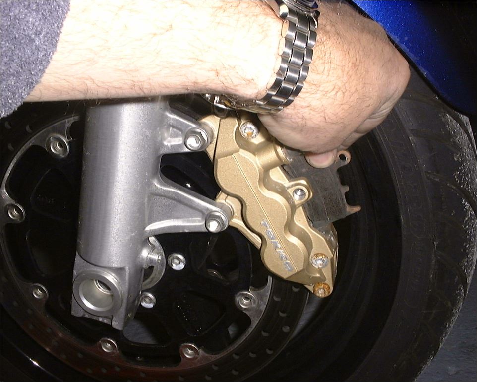

Now we can remove the caliper from the fork leg, do not twist or strain the brake hose and do not allow the caliper to hang from the hose, keep the caliper supported at all times (a bit of string between caliper and handle bar if you get disturbed and need to leave the job for a while).
Filthy caliper yuck! Now I squirt on the motorcycle cleaner (muck off etc.) and give it a good scrubbing with my paint brush and then a good scrub around the pistons using an old tooth brush using plenty of clean water to rinse the cleaner and dirt off. Aerosol brake cleaners may help with the final cleaning if you still have hard to shift filth.

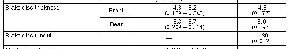

I reckon your disc is below the wear limit, you may need to consider a new one before the MOT....... :lol:
