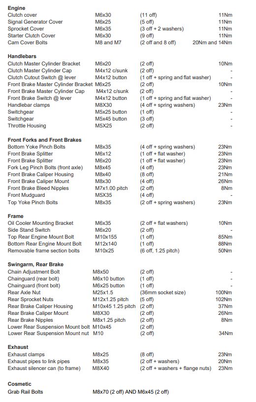

GSX1400 Bolt Sizes
Started by gsxbarmy, Friday, 03 February 2017, 09:00 AM
Jeez Barmy.... you might have put this into alphabetical sequence!  :stir:
Seriously... you are a star for doing this  :clapping:
Basil Brush
Wish I read this two days ago - just fitted some Givi bars. I thought Suzuki metal was soft. Givi metal is in another (lower) league. Managed to strip a head on button allen bolts.
Cut a long story short. I had a pair of M8x35 fork pinch bolts. Going spare. Fitted a dream. went on eBay. Yeah - you can guess - ordered wrong size. Bollocks.
Barmy - you are an absolute star...
BB.

Ok, as per your requests, I've now put it into more sections, in alphabetical sequence AND added torque's  :onya:
Quote from: gsxbarmy on Saturday, 04 February  2017, 10:32 PM
Well done...Very helpful :clapping:

I did wonder Pete but it wasn't an unreasonable request, so I thought what the heck - and if it makes it more useable then it was worthwhile :)
Actually it was quite fun doing it......!
Stolichnaya
Can anyone (queue Barmy-Guru) tell me the 4 bolt sizes I need for the Grab Rail please as I cant see them above and I need all 4
Thanks
Stoli

@Stolichnaya
Give me 10 minutes and I'll remove mine and measure them for you :onya:
