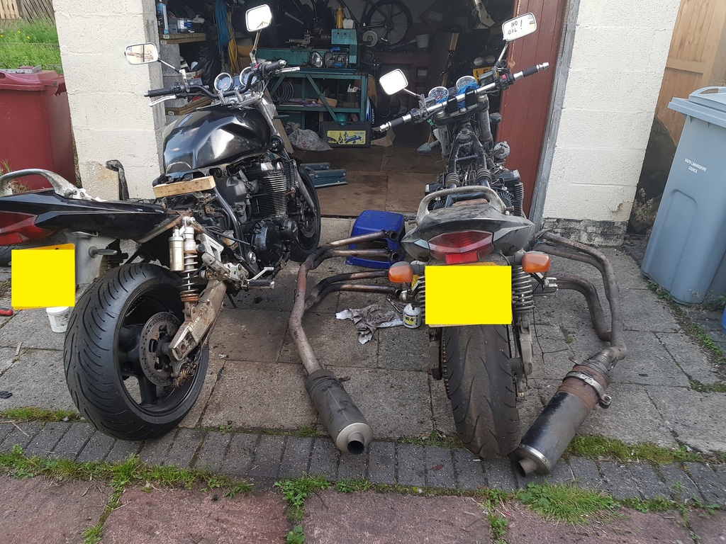

Ok, some real progress ... 8 header bolts removed without too much problem, even after sitting for 7 years and exhaust removed :notworthy:
Going to buy some thread restoring taps so I can give all threads a good clean.
I've dug out the lift thingy I used before to remove/replace engine, so I think I'll have a go at dismantling the bike to tomorrow  :cheers:
All the best ... Barry
Still alive ... just!!
BanditsHigh
Praise be to the exhaust gods ... two sets of header bolts removed without major issue and two exhaust systems removed  :notworthy:

What a hellish two days  :frustrated:  :frustrated:  :frustrated:  :frustrated:
1) Will be stripping bottom end of K4 so removed clutch because I couldn't remember whether there was a plate in behind it joining the two lower halves of the engine casings (there isn't).
2) Removed k3/K4 sprockets covers and all the bits behind (including sprockets).
3) Finally got all frame nuts and bolts undone on the K4, apart from two (see below).
So, now ready to take K4 engine out.
I got my bike lift thingy and cut a few bits of wood to act as spacers, five minutes later engine was lifted without issue. At this point I decided to take front end off as I was going along the 'lift frame off engine' route.
I got the nuts off the two rear mounting bolts without a problem (frame to rear of engine) and that's where it all went pear shaped.
They won't rotate or move at all, tried heat, tried a two pound mash hammer to belt them through, nothing ... tried a half inch drive ratchet with a four foot long pry bar ... nothing moved and now the head of the lower bolt has started to round over as the socket went at an angle.
So for the moment I'm stuck and I (probably) have the same to go through with my K3 engine as well.
Only thing I can think of is ...
1) Drill the bolts in the centre so I can snap them in half, then weld a big nut onto each end and hope that the thermal shock is enough to break the bond ... means I'm only trying to break bond on one end at a time, therefore half the amount of force required (maybe).
2) Maybe drill the ends of the bolts about 10mm deep using a drill about 1mm smaller than the diameter of the bolt, hoping this will then allow the weight of the engine to shear the bolt between the frame and the engine, but can only do that with the top bolt as bottom has limited access.
I can access the bottom bolt by putting bike in its side (to split in half), but for the top I'd probably need to destroy the airbox to give me access.
I'd probably still need to get remainder of any bolts out of the engine lugs, but once out of the frame it'd be easier.
Anybody have any other ideas?
