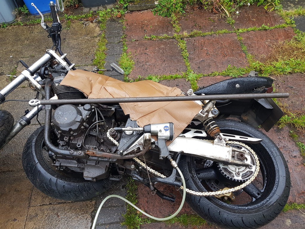

So after two and a half days I've finally managed to get engine number one out (knackered engine on K4).
Two days just to get the two engine rear mounting bolts out, using lots of heat, lots of WD40, a 1/2" ratchet, a four foot tube to go over the ratchet for extra leverage and finally my air driven impact driver (think this is the third time I've used it).
Undoing the lower bolt I though I'd broken my ratchet as there was a loud crack as I used it and the long tube, but saw a little mark on the bolt I could keep an eye on, next few loud cracks showed that the bolt was moving and fifteen minutes later it was spinning like it had never been stuck.
Upper bolt didn't take very long, thankfully.
Took me a couple of hours faffing about until I finally got the engine out, I'd forgotten how feckin massive it is!! To think I used to be able to lift that from the ground and put it on a bench, but not anymore, it'll be hard enough getting it off the lift!

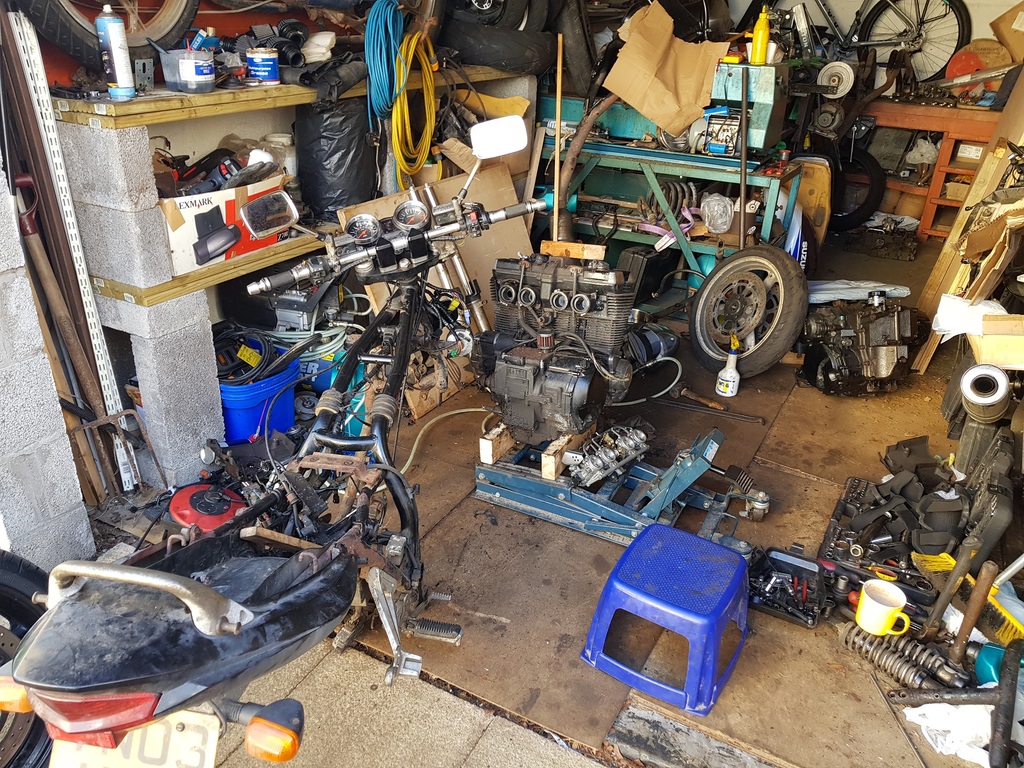

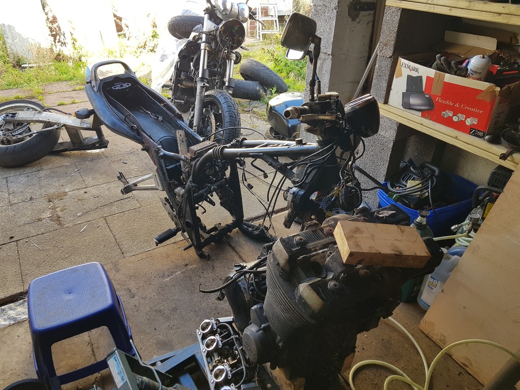

I started with the rear engine mounting bolts this time, and after the debacle with the first engine it all went pretty smoothly this time, more heat, more WD40, breaker bar and impact driver again.
So just over six hours total (with lots of sitting down and getting energy back), loads of cuppas and that's the K3 basically broken down, it's beginning to look like a breakers  :lol:

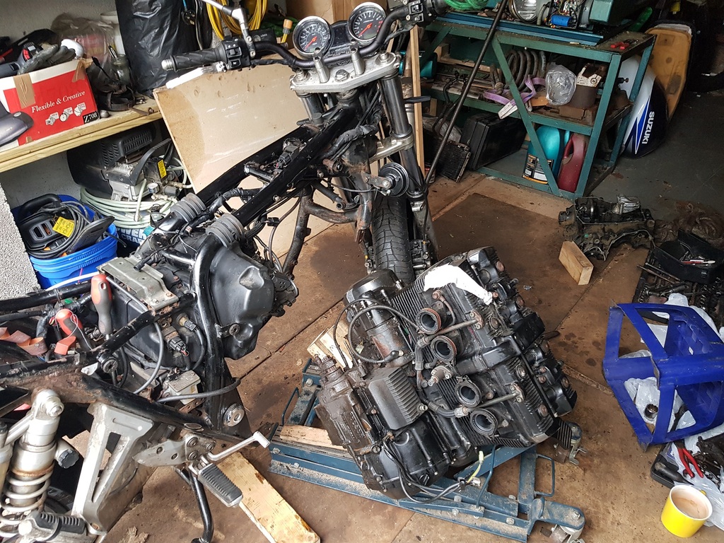

So, tomorrow I'll strip airbox and any other extraneous bits off the K4 and fit (hopefully) the K3 engine. I'll need to have a look at the PCIII and see if I have a map somewhere and reprogram it.

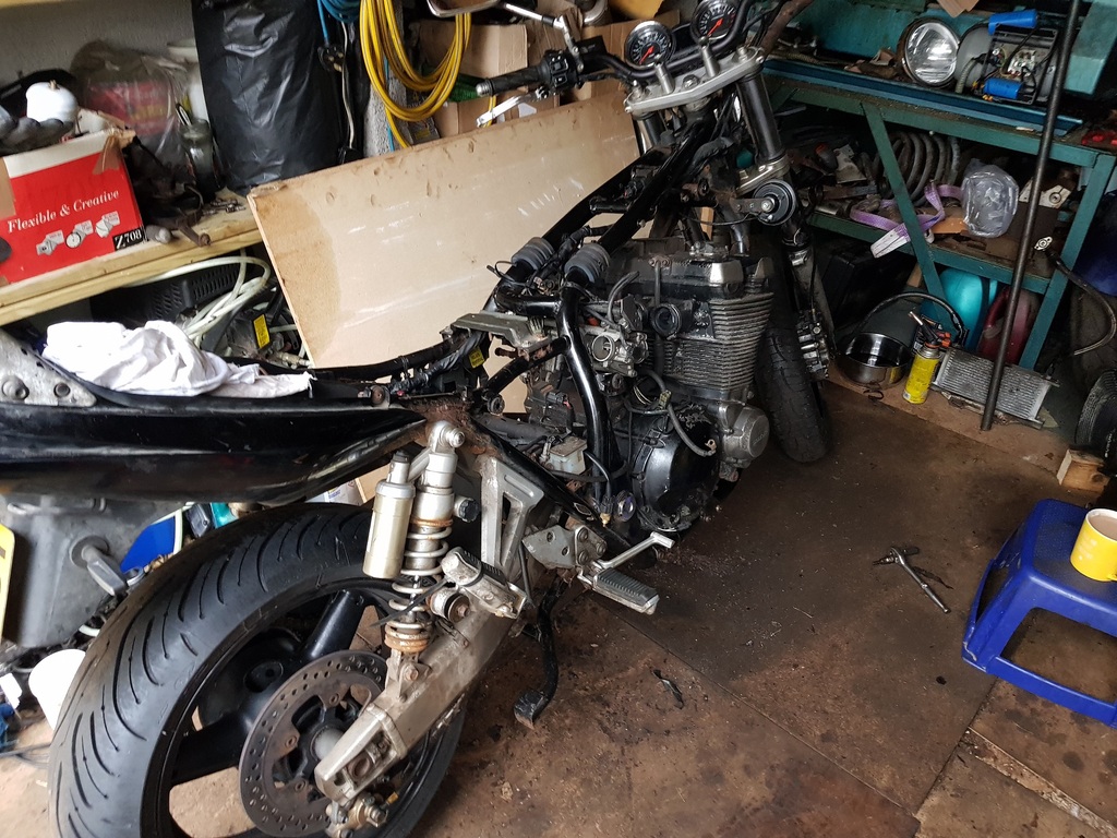

Anyway, back to the engine ... after a bit of jiggling around I finally managed to get the engine into the K4 ... it only took a couple of hours and most of that was getting the first rear engine mounting bolt in.
Tomorrow, plug everything in, fit throttle bodies and filters (need to go back out and get them to oil tonight), fit exhaust system, fit oil cooler and new filter, fill her up with some lovely fresh oil and maybe see if I can get the PC-III programmed.
So part of my K3 (the engine) will live again tomorrow for the first time in seven years ... looking forward to the extra 25% power  :notworthy:
