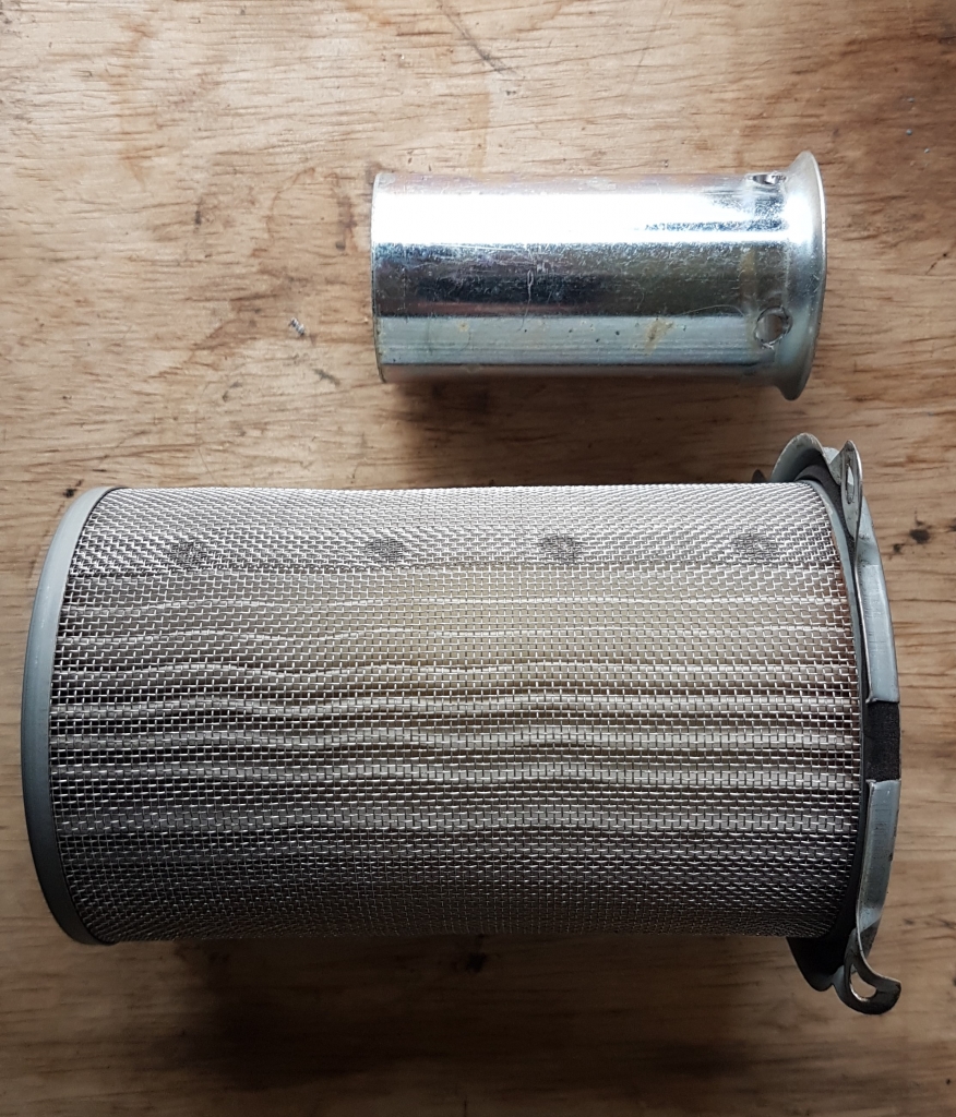

Had a significant induction 'sucking' noise since I bought the bike. Not any more. Ordered a genuine filter for abut £37.
If anyone is interested what the pipe looks like on the non OEM filter:
Yup & even after removing that, the hole is still smaller. Plus the bike doesn't run as well as a genuine filter, at least mine doesn't. I assume it's because it's not a smoothed intake & restricts how well it breathes.

I guess that along with the intake hole size, the filter media might not be as free flowing in the third party filter.
You could be right. I'm going on the extra noise, which is normally a sign of restricted flow.
Anytime I had pods on a bike, my Katana with CR carbs there was increased noise that wasn't because of restriction in flow.
My RD400 runs standard and has high induction noise, don't think it's from low flow. So I suppose it works both ways.
True, but then you didn't have an airbox to hide the noise either so it would be louder.
I'm sure you know noise is vibration & the only way airflow will produce vibration is via turbulence, which will restrict flow.
I'm no expert on this though, I just know those aftermarket filters made my bike slow & thirsty. Taking the intake pipe out of them helped at low throttle/speeds but it still didn't run properly and it had a lot more induction noise in normal riding.
