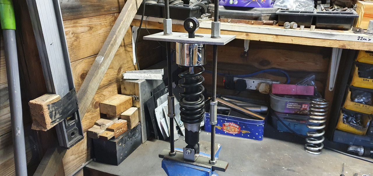

I have a couple of shock rebuilds to do, so knocked this up today.
hard road
I made one a while back, crude but it works.
This little Hagon was apart in second with a few turns on the screw jack.
With the top ring type do you need to have different sizes of collars for different shocks.
Irish. that Hagon looks like it should be in the bin.
Quote from: grog on Saturday, 09 September  2023, 06:07 PMIrish. that Hagon looks like it should be in the bin.
Actually Grog there is nothing wrong with the damping rod or seals due to it having a protective shroud. A wet blast a new coat of paint, new bolts and top nyloc nut it will be new again. Then my 250 Superdream will handle like a dream.
