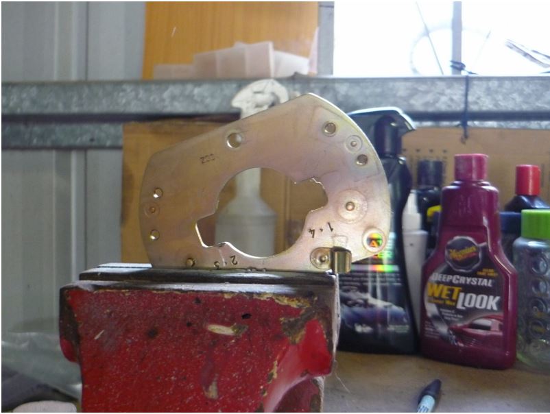

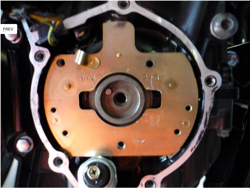

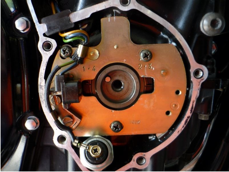

There have been some queries by forum members following purchasing a GSX1400 as to whether or not they have the standard ignition rotor fitted or a third party 'aftermarket' one (typically from Factory Pro) which advances the ignition by 4 degrees.
The picture (below) should help you identify which type is fitted to your machine.
