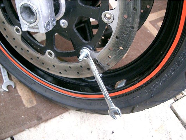

The GSX1400 has “floating” front discs where the actual discs are held to the disc hubs by bobbins (the circular looking things with holes through them!), which get crudded up over time with brake dust and other road dirt and need clearing out to make them float freely again. To clean them is quite and easy and simple job to do.
First, obtain an 8mm bolt and 2x13mm nuts. Thread one nut onto the bolt and insert it through the bobbin from the inside. Now thread the other nut onto the bolt and thread it up so its tight enough to just grip the bobbin (i.e. you don’t need to heave on it, as the bolt needs to hold the bobbin enabling it to turn without compressing it).
Now using a spanner on the end of the nut, turn the whole bobbin assembly whilst at the same time spraying brake and clutch cleaner fluid into the “gap” between the bobbin and the disc. Keep turning and spraying the bobbin until it turns easily and all mucky has been removed (the cleaner will run clean rather than dirty)
Repeat for all other bobbins on the disc.
Once you have completed cleaning all bobbins, wipe discs over with a clean dry cloth to remove any residual brake and clutch cleaner residue that may possibly remain.
Mine's an FE with standard discs and an M8 bolt won't go through the disc bobbins...I had to go right down to an M5 to do it.
It worked a treat though and got rid of the worrying knocking noise from the front end :onya:

Did mine today.
Mines an 08 plated bike.
There was no hope of getting a bolt that big through the bobbins.
They look similar on the outside but much smaller on the inside.
I ended up using a smaller nut and bolt that only had 8mm heads.
I added a larger nut and washer to stop the 8mm head being pulled into the larger side.
2 x 8mm spanners to make sure they will turn, and give them a bit of a free up.
8mm socket on a drill and a good drink of brake cleaner.
When I started none of mine would turn by hand.
Half hour later they all turn by hand and heaps of muck washed out.
i just use the nut/bolt thing. ratchet n socket. lots of brake cleaner. never tried the drill, will next time. seems a great idea.
