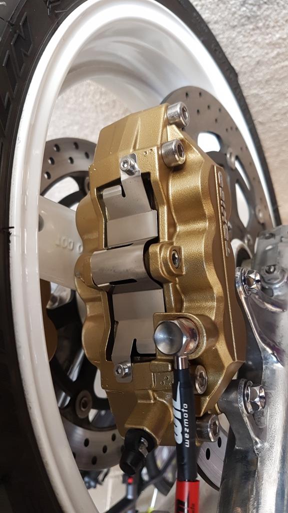

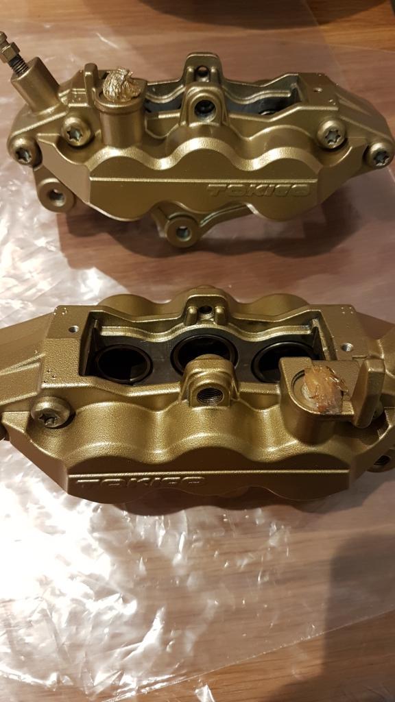

Gave mine a bit of a rub down and a clean off, then masked the bits with the pistons. Repainted, new fittings, and used a Dremel to carefully polish the paint off of the logo. Then replaced the brake hoses as they were the original ones and looked a bit tired. Think they look OK for a quick refresh. None of the pistons were seized so no further work required.
@numbskull They've come up a treat.

Quote from: numbskull on Monday, 13 April  2020, 10:00 PM
Great job mate they look like real gold  :stir: :stir: :stir: :stir:
