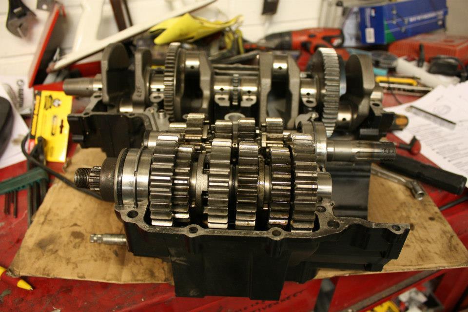

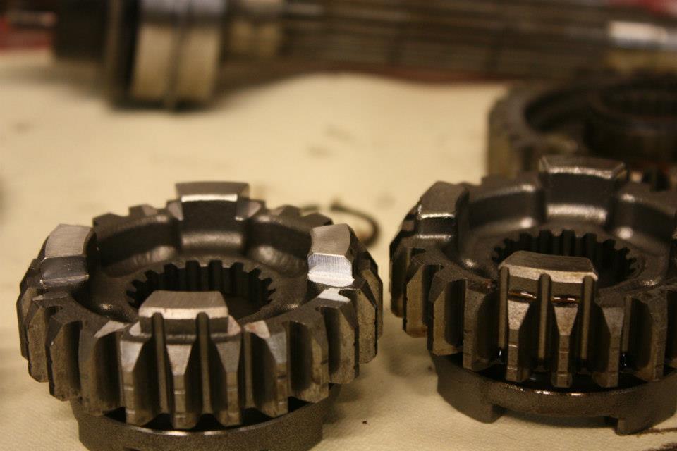

So, 2nd and 6th gear are both engaged when you have 2nd gear on. All the power comes "thorough" 6th gears sprockets where the second gears sprockets attach (the two most left sprockets, 2nd gear engaged):
There's the 2nd and 6th driven gears, on the axle where the front sprocket attaches. The smaller sprocket "locks" to the small windows in the larger spocket. On the earlyer 1400's these where made form a bit different material and so some of them had the gearbox problem more often. In the later models it was fixed but still some got broken, along with mine. Two times.
Anyhow, whilst accelerating, especially when shifting without clutch, these parts wear and when they start to be round the 2nd gear dont lock as well anymore and starts to bounce. And now we have a problem that just gets worse every time it happens.

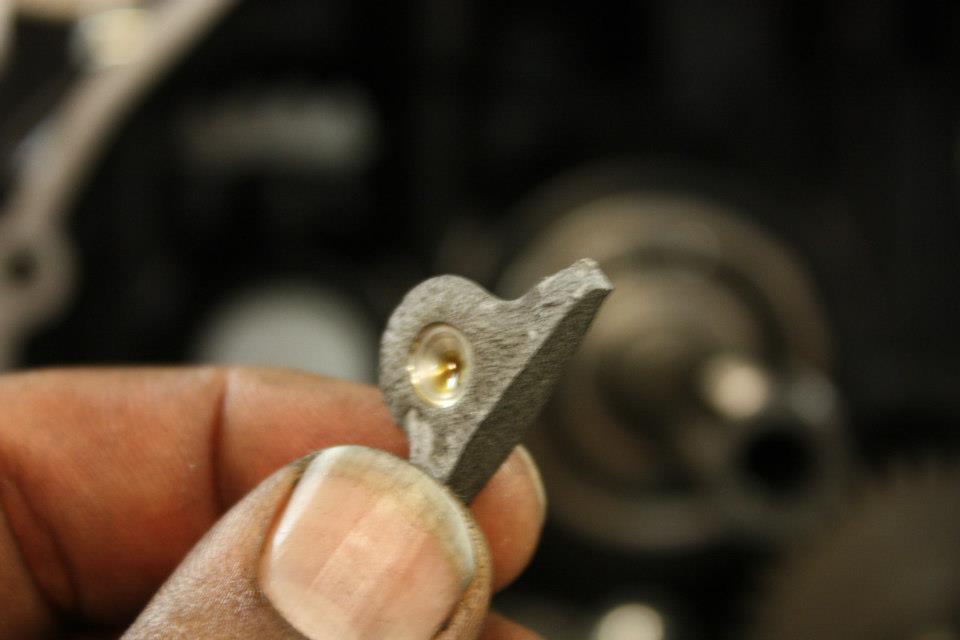

After the gears bounces for the first time it does some damage to the gear shifting forks (they move the gears in right positions when changing gears). The gearshifter fork bends a bit and starts to wear too. After a while it looks like this:
And one doesent have to be a rocket scientist to figure out that this makes the problem even worse. Added to this there's allso the axle where the gear shifter forks moves - it might bend as well and that leads to a situation where the second gear doesent keep engaged at all. This happens actually quite fast from the first "whattahellwasthat" moment.

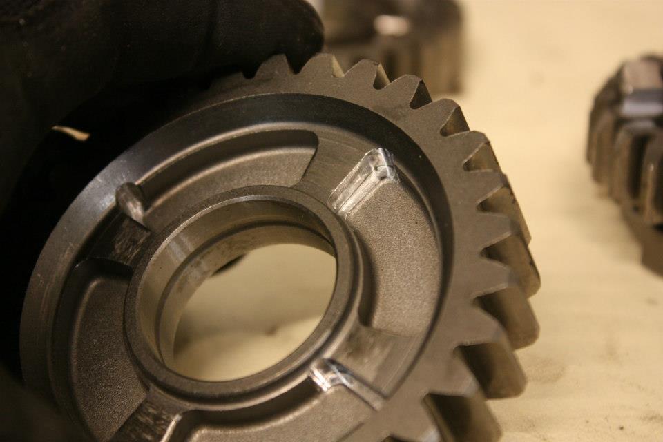

Undercutting the gears.
In most cases there are no other damages to the engine exept the 2/6 gears, gearshifter forks and the tubes (referring the axels as tubes as they are not solid) where the gearshifter forks slides around. You can also use the old sprockets after they have been machined, undercutted as those in the picture above. The idea is to machine the slots in small angles so that when the gear is engaged it will hold better. Suzuki did it the first time with -92 GSXR 1100 to keep the gearbox from pulling a part. In 1400 other gears are undercutted (looks a bit like a fishtail, look at the pic below, uncut sprocket at the right)
but the 2nd gear is left alone to help in finding neutral. When you have undercutted gears (especially if you have similar than the sprocket above, it has up- and downcut, or a full "race cut", to hold the gears allso during engine brake - not that usefull or necessary on a road bike...) you might have to change to 1st gear first and then up to get neutral.

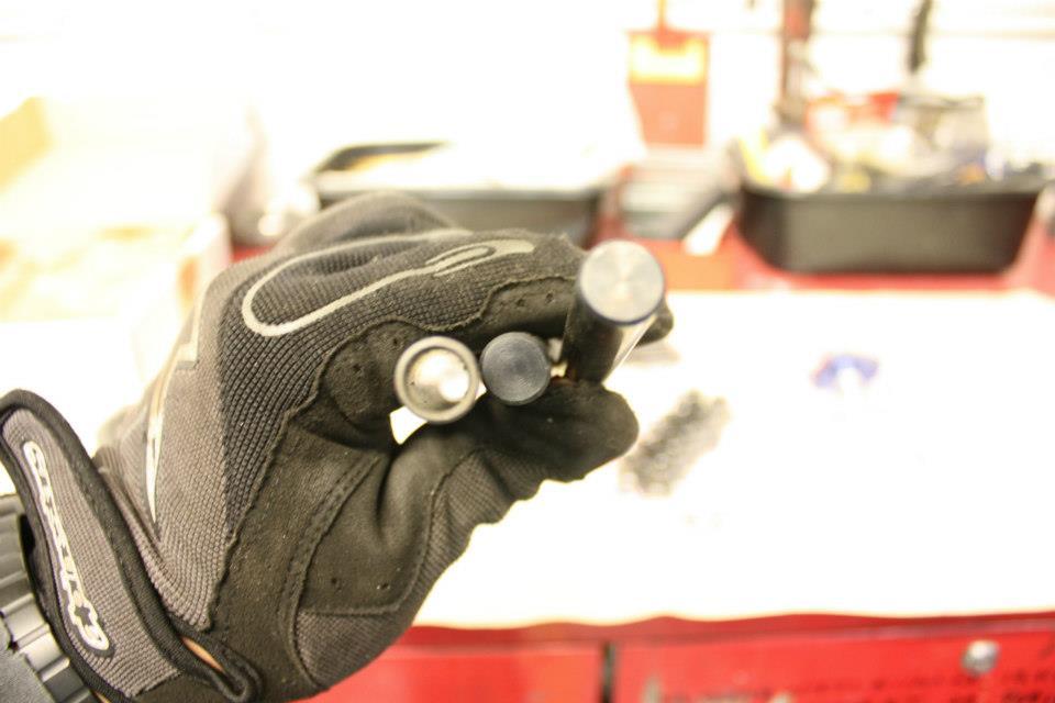

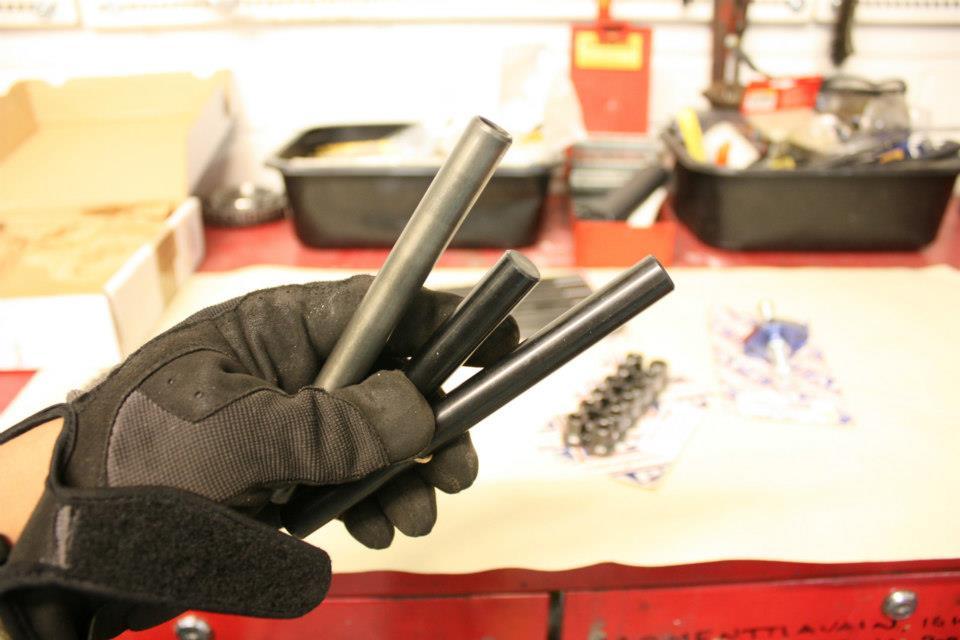

The other thing is to change the gearshifterforktubes to heavyer ones that dont bend that easily:
OEM tube at the left, APE raceparts axels (1st Gen Busa performance parts for drag strip) at the center and right, you can see the difference. They wont bend so it shoud make a difference in gear shifting and the lifespan of the shifterforks.

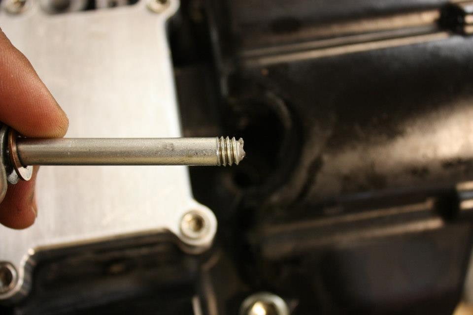

While doing your fixing, order a set of new bolts for the cases and use the torque wrench. Them bolts doesnt take loosening and tightening that well, at least multiple times. It's way cheaper and faster than having a bolt snapping in the engine halves:
...and check that the geaxbox axle bearings are in the right position (the holes line up with the retainer studs) to avoid further delays...

Thank you BA! That was all I needed to know, unfortunately a little bit too late, I studied all that by my self and ended up the same result!
I had exactly the same problem with my second gear. And what did I do:
-Undercut 2 and 6 gears (5 degree)
-New shift forks
-New, billet made Hayabusa shift shafts
I havent tested it yet, but maybe next week, and I really hope that all this helps, and I can use power again.

Test run is done. Works great. No problem to find neutral position with undercut gears. A bit cold and slippery out there..
BlackAdder
Nice to hear that it works. My gearbox was a bit stiff on returning the pedal after upshift for some 500km but now it works as well. And I dont have any problems finding neutral either.
