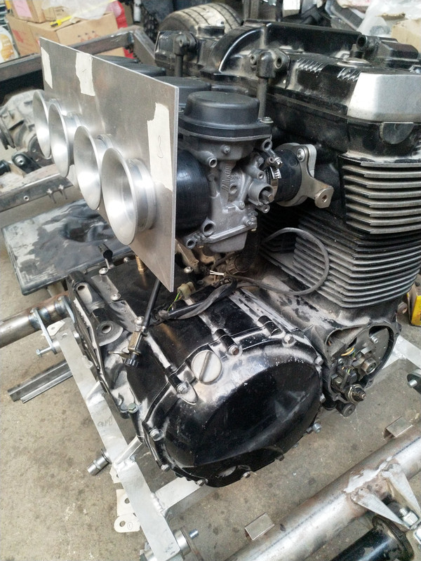

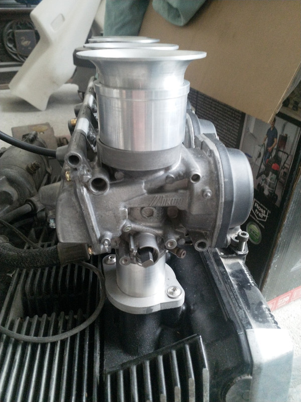

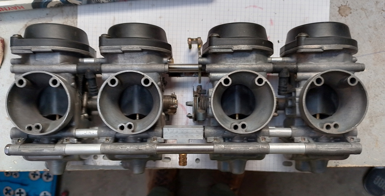

The carburetor rack is almost back together, i built it up more or less in order to confirm by how much i needed to extend the choke plate.
Also carb nÂș2 needs an extension for the butterfly control to reach the master carburetor
The Bandit spacing of the outer pairs aren't an exact match to the cylinder ports, so i only spaced out the center pair, but i should be able to get away with it. It would have taken a lot more machined parts (and money) to move the two pairs in by 2mm, didn't seem necessary since the rubber on the spigots will have some play, and would have been quite a hassle

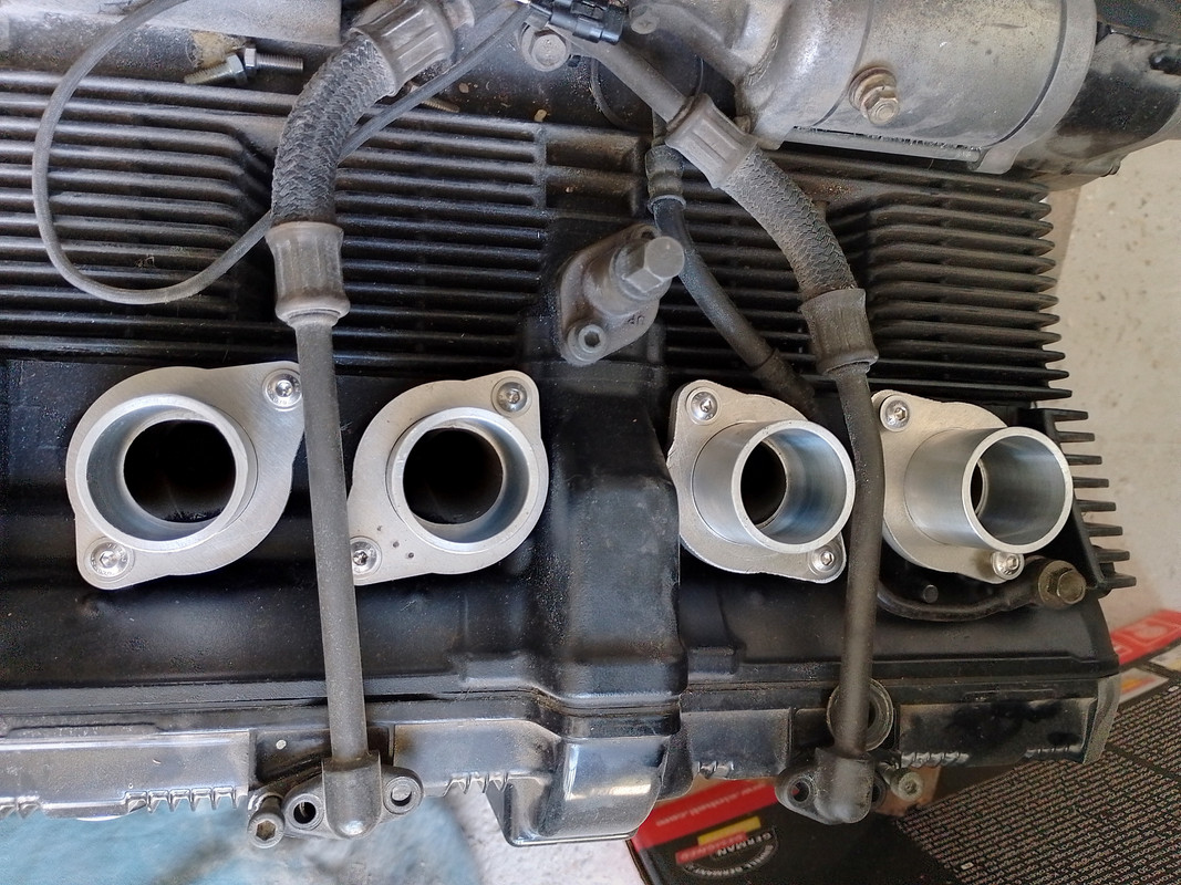

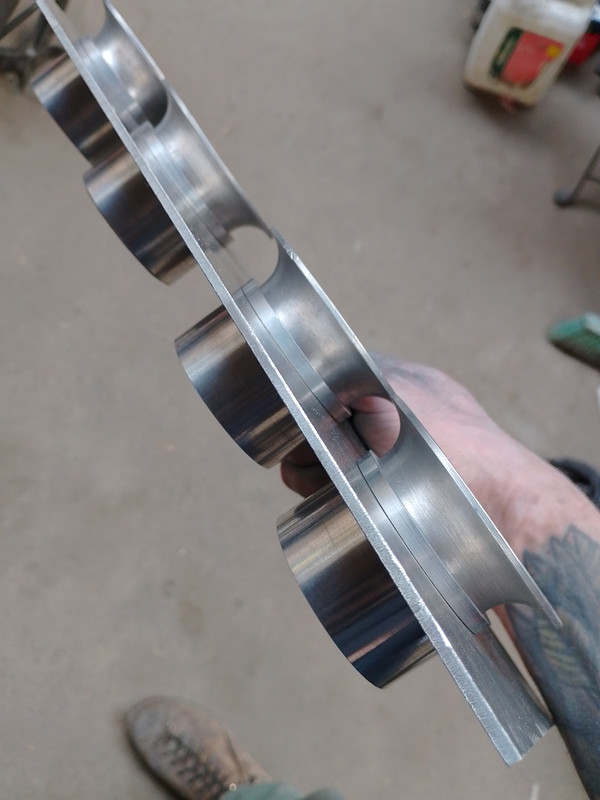

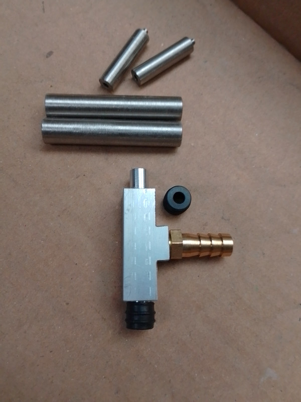

An the spigots are also pressed into the base plates, ready to get welded :
Joseph
Also a guideline to how much i can port the intakes, which will improve engine breathing

Indeed, i've found a good guy to make the stuff i can't  :onya:
Here's the full intake tract setup and plenum base, that now all needs to go to another guy who knows how to TIG weld alloy

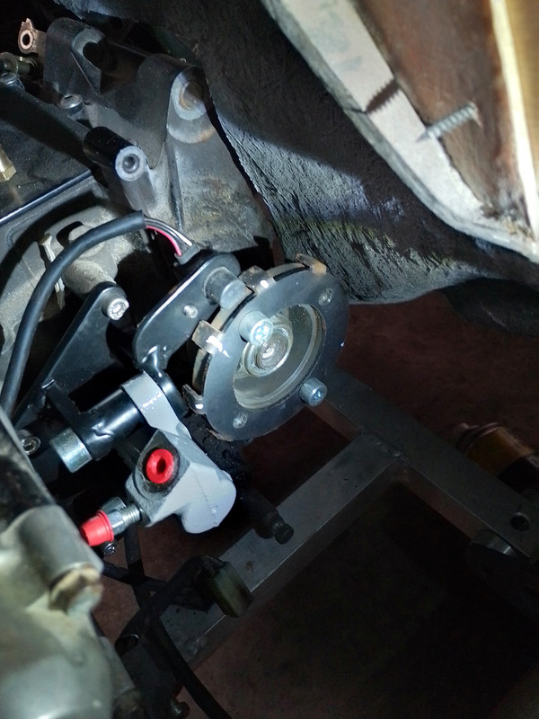

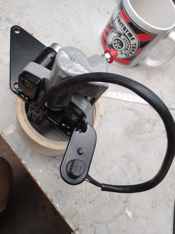

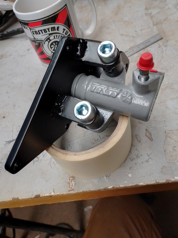

A bit of a headache solved.
Obviously running a propshaft straight off the gearbox meant that i no longer had provision for the clutch slave or the speedo sensor.
After sorting out the prototype (tracing out the engine case screw dimensions), i selected a car clutch slave that i hope will work enough, and also set the tab for the speedo
Welded (by me  :whatever: ) and back from the powdercoater today
And on the car, with the flange adapter replacing the sprocket, and the laser cut ring i designed with the sensor points on it
