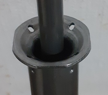

Anyway, I managed to uninstall one cartridge without the holding tool and noticed that there are four little holes in the head, 17,5 mm apart, 25 mm diagonally. I made a tubular tool with four pins matching the holes and by using this tool I managed to uninstall the other cartridge.
I assume that the Suzuki tool might be similar to the one I made and that's why it is suitable for all 14's.

Pictures:
The tube I used is a bit too large, that's why I had to bend the pins inwards. Before installing the cartridges back to the forks I will make a better tool using a smaller tube.
