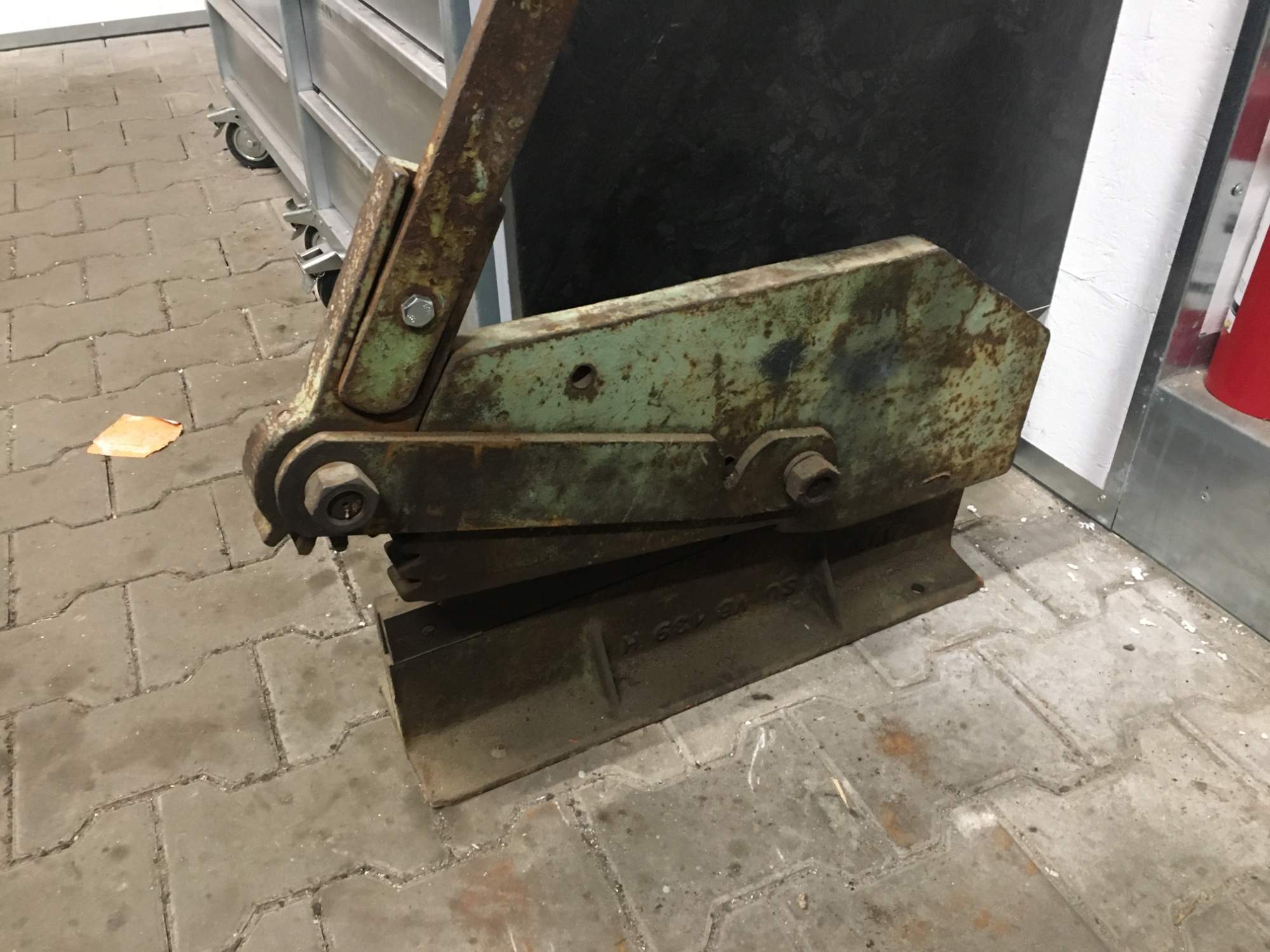

My new tool from scrapyard. Now waits for restoration.
Metal sheet scissors ELCHRON NPR 300/6 Can cut steel up to 6mm thickness. Weight 60kg

So today I started with NPR300/6 scissors renovating. It will be challenge. Absolutely all parts are damaged.  :thumbs_down:
But what would one expect from a scrapyard...

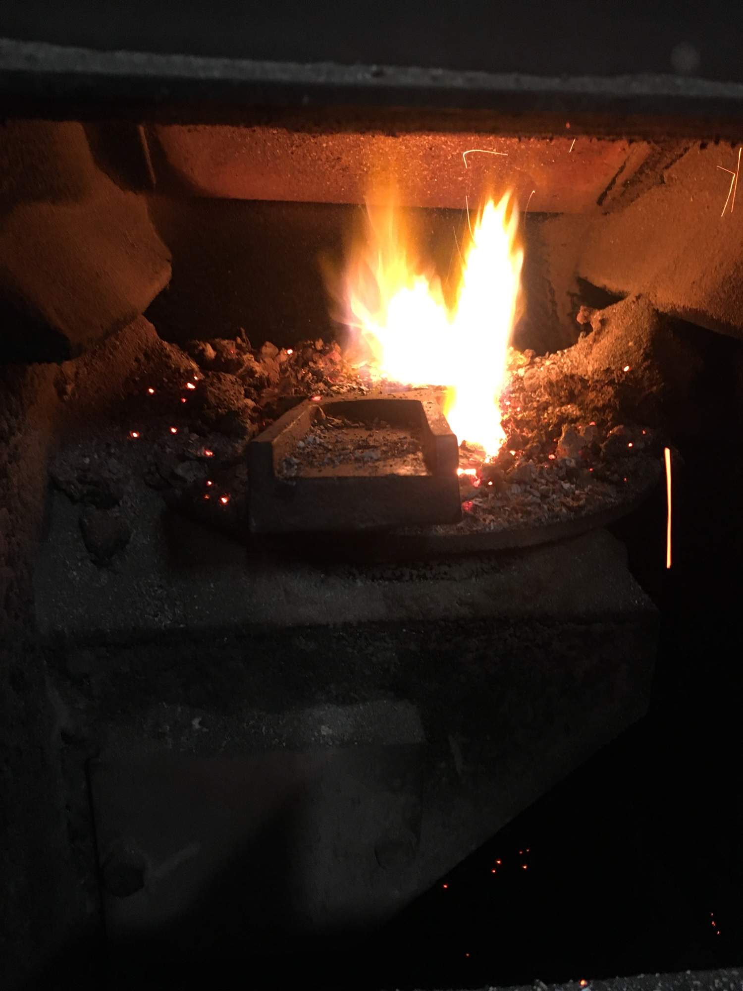

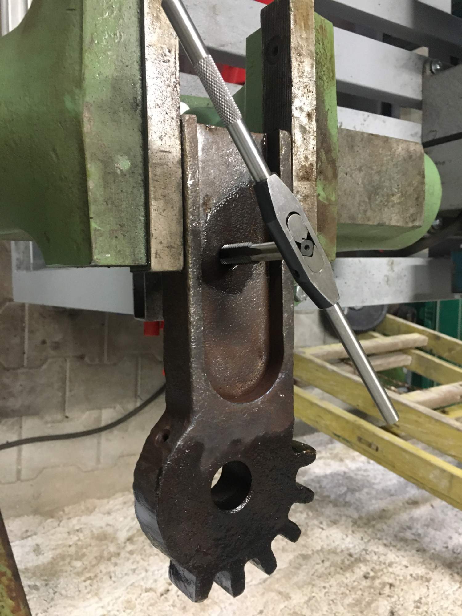

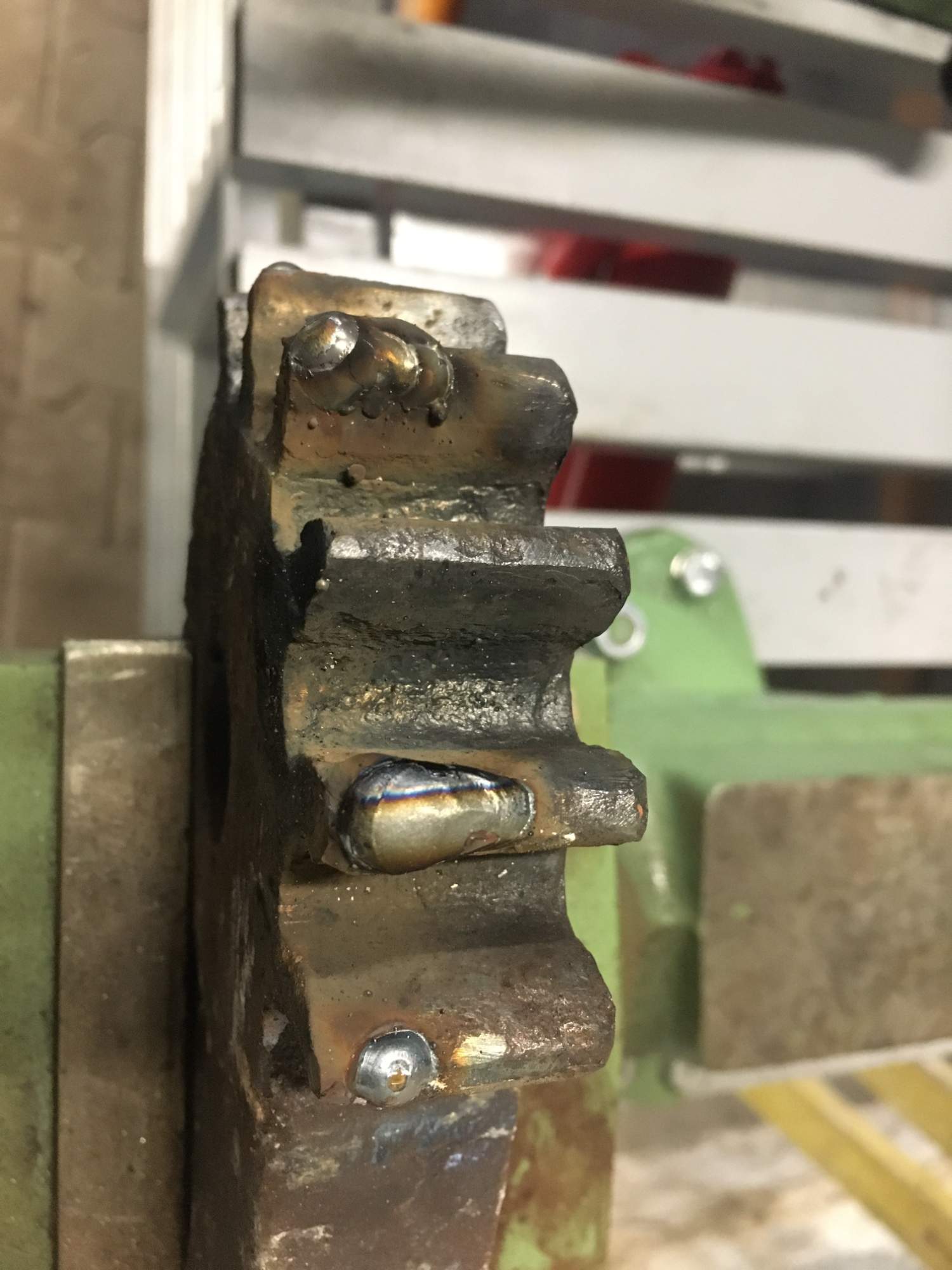

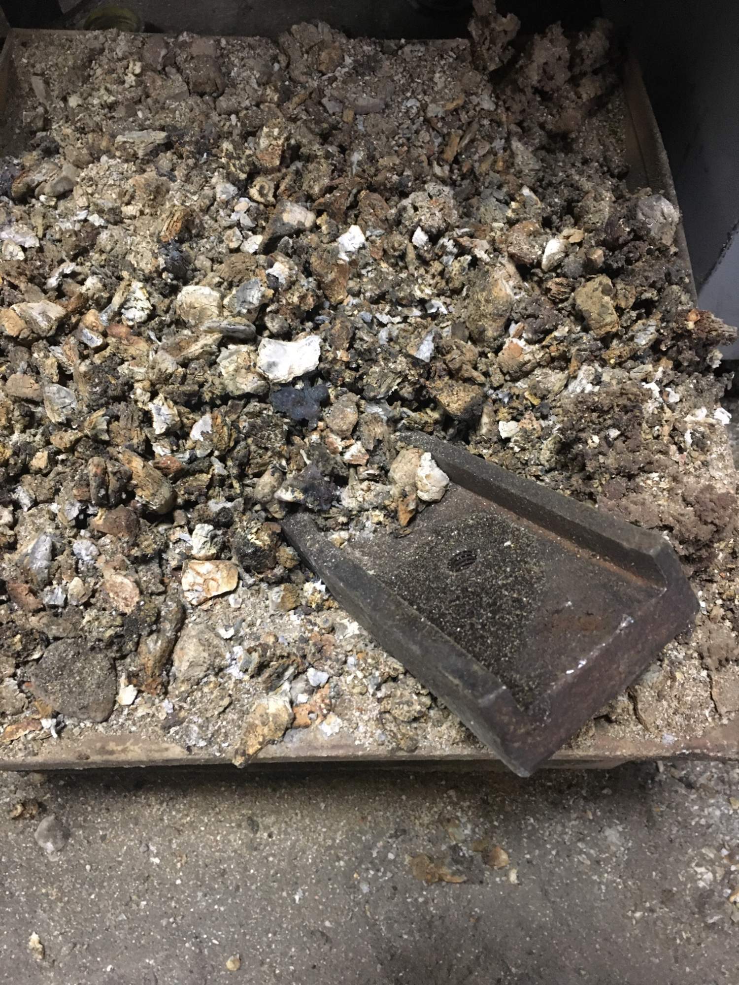

Today I disassembled the scissors and repaired the first part. I repaired damaged teeth on the lever. The only problem is that almost all parts are made from "litina" in my language. Cast iron in english probably. This material is complicated to weld. It must be heat up before welding and cool very slowly.
Here is my solution.  :twisted:
Heating in boiler...
Welded by PP315.21 posted earlier here...
Slowly cooling in hot ash...
Finished ground teeth and repaired thread...

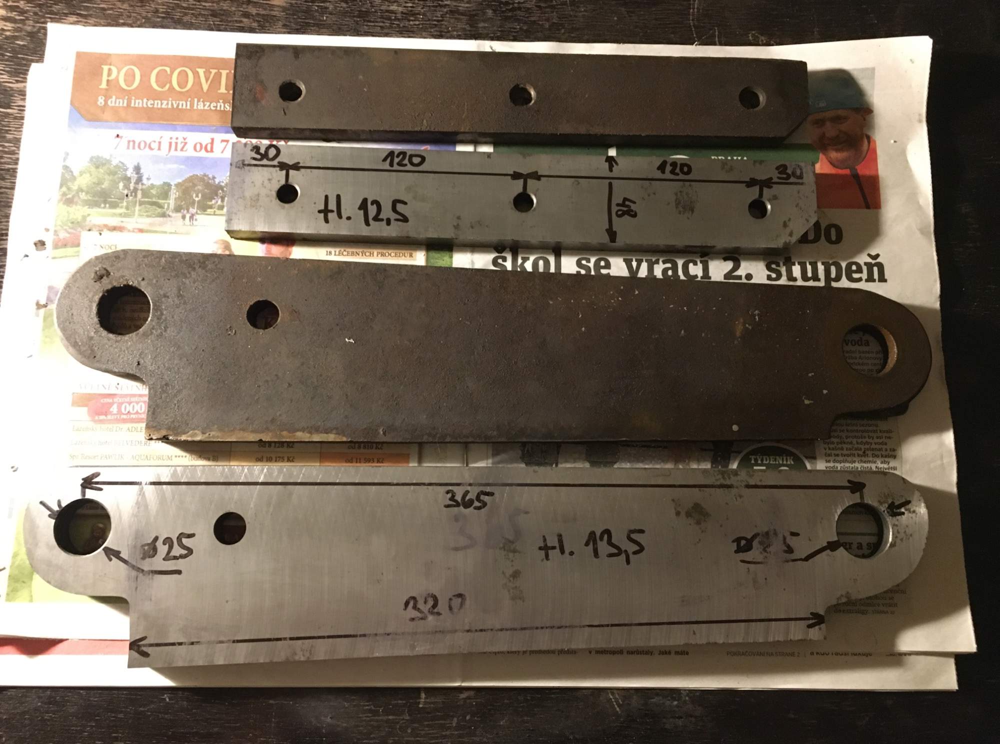

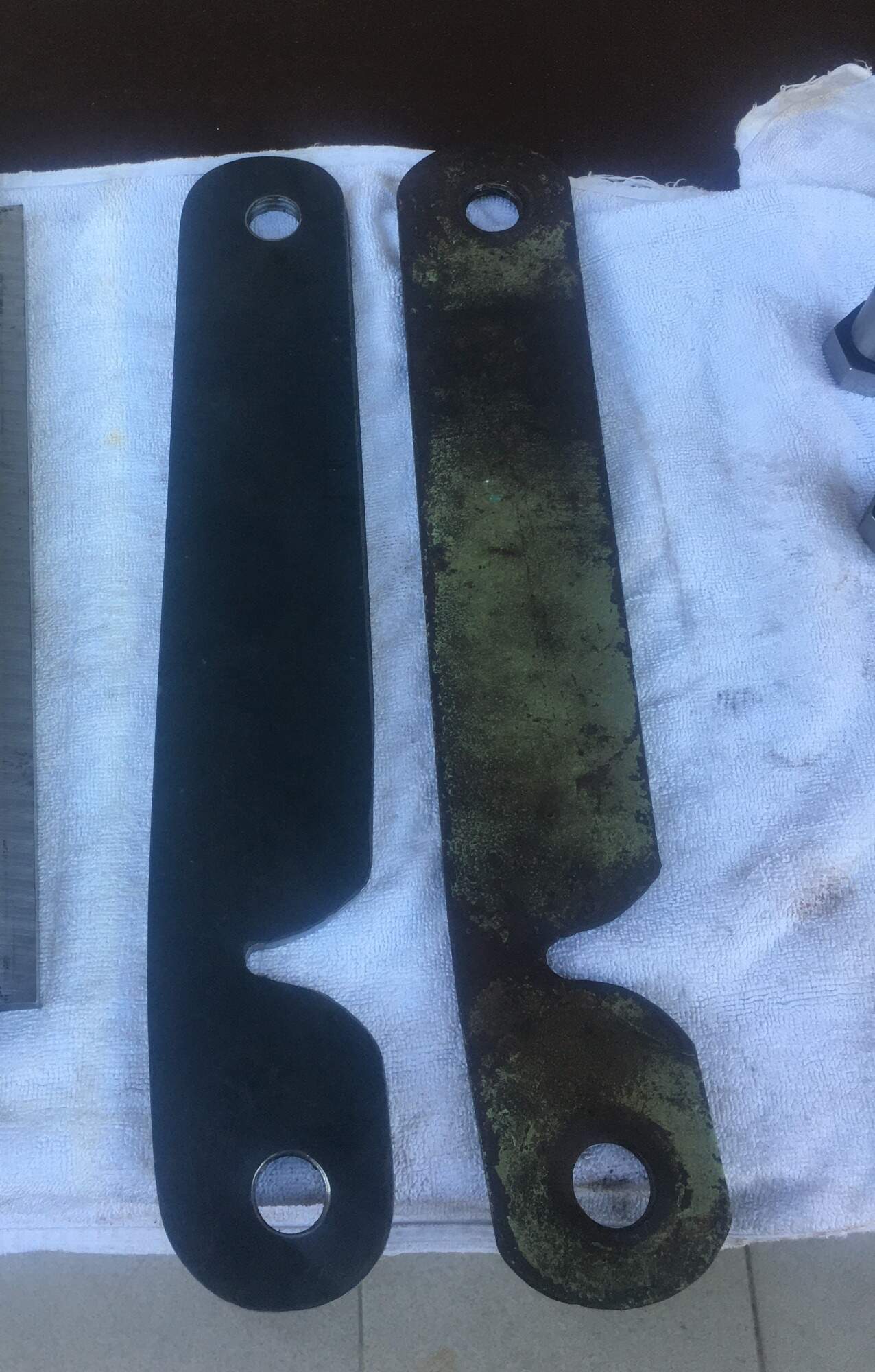

Next part for scissors ready. New jaws. Made to order because the manufacturer of scissors no longer exists.
Next part will be main body. It's totally squeezed. Needs to make some housing for a new precise screw.

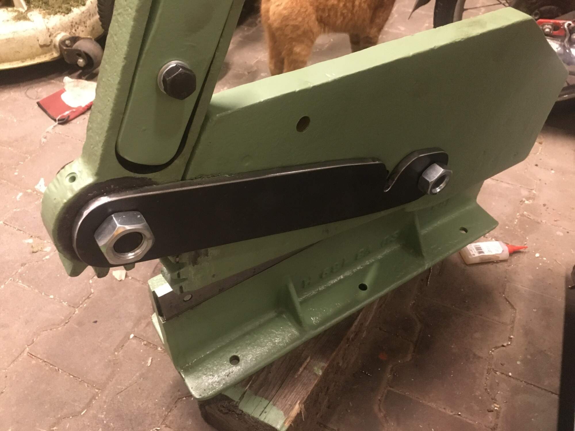

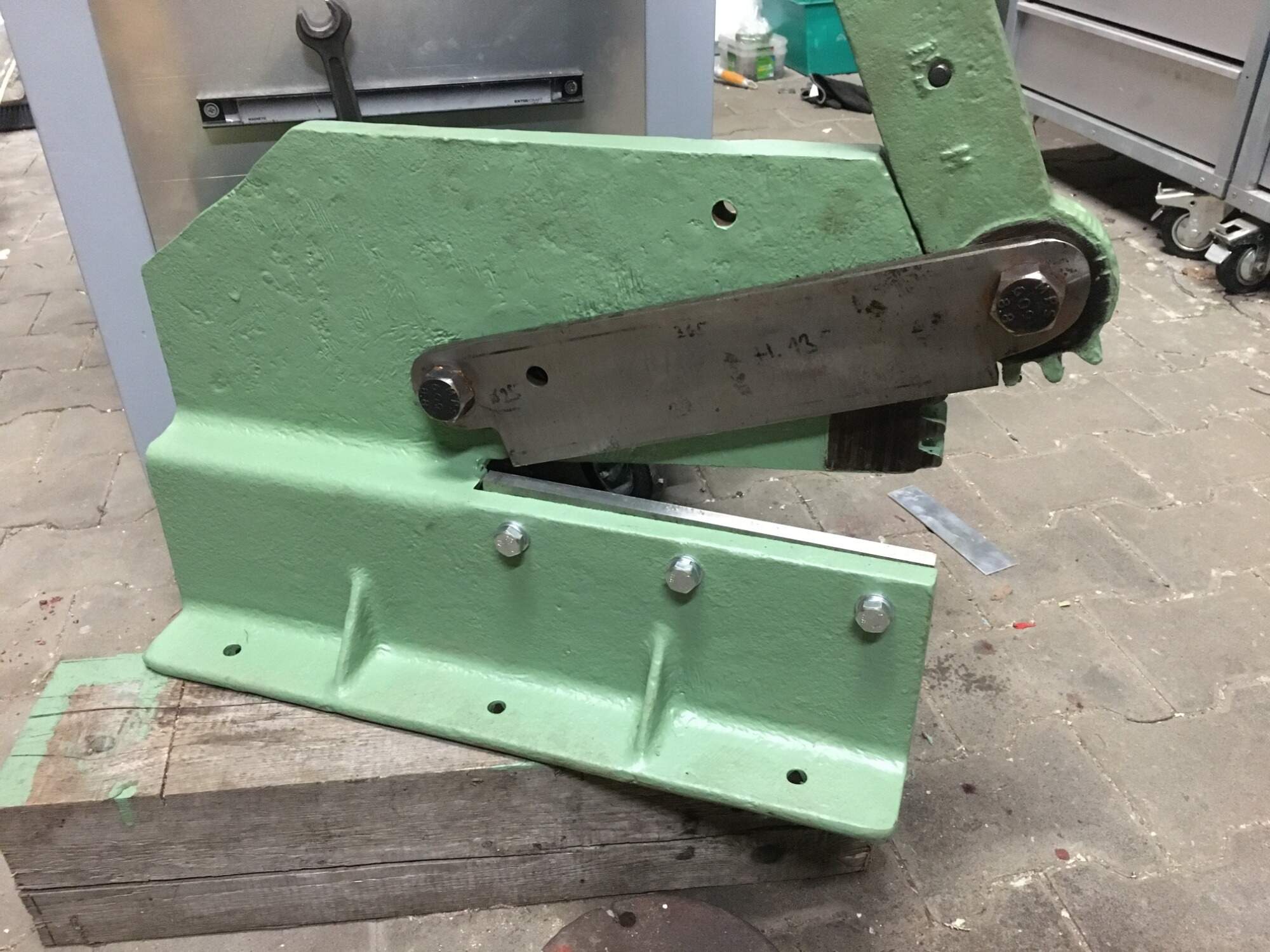

Finally almost done. All I have to do is paint one part and make a stand. They work perfectly. It is not a problem to cut from paper up to 6mm thick iron.  :boogie2:
PS: Excuse the mess in the barn and the cat in the photo (everytime wants to help me)  :rofl2:
