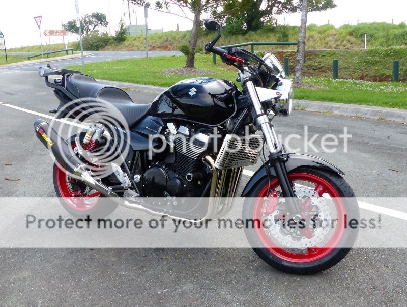

SV1000 ones on mine, straight swap. Refurbished them and powder coated satin black before fitting. Much better feel to them than the standard 6 pot calipers.
Rod G
Those red wheels will give you away Bro!!  Nice allround.. That red paint will likely allow it some speed and probably up there with the blue/white.   :rolleyes: :rolleyes:  Rod G
