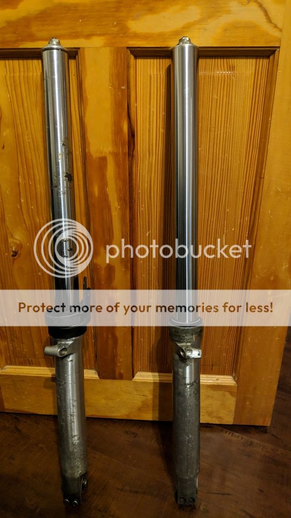

« Last Edit: Monday, 20 August 2018, 07:24 pm by Speedy1959 »
