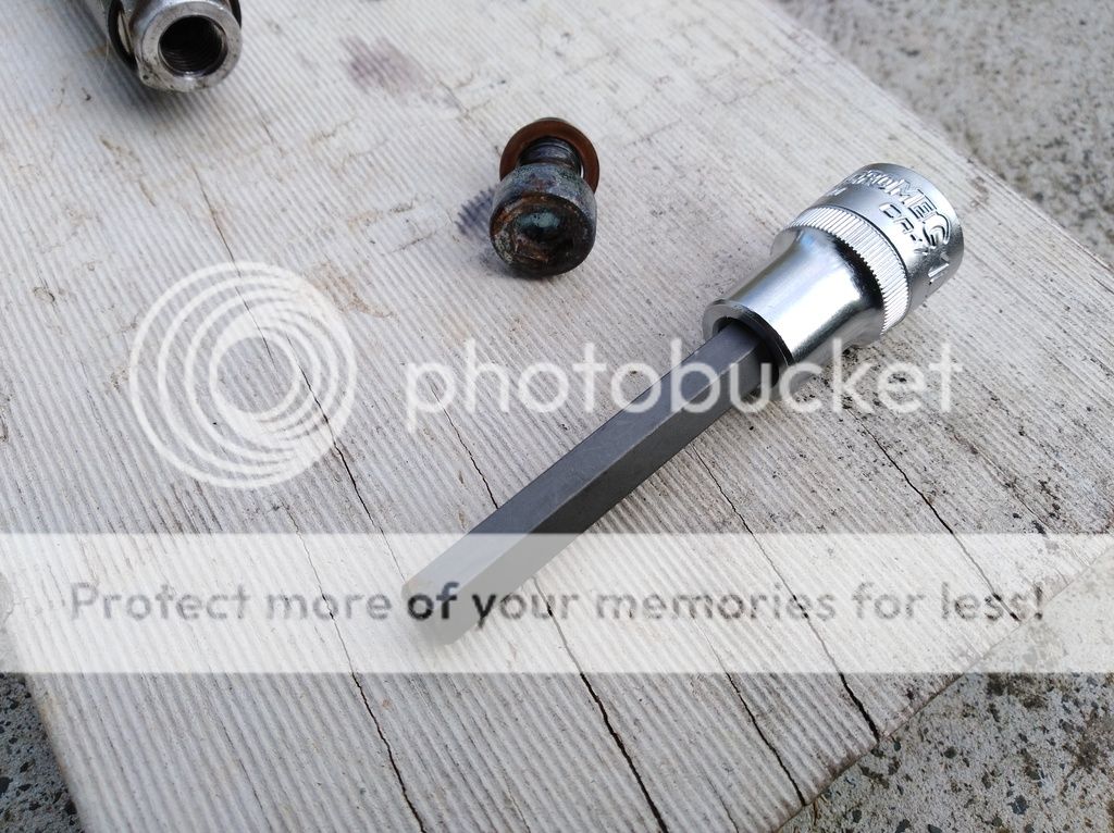

Here's some pics in case anyone is interested.
First is that internal rod everyone says you need to "fork tool" for. The bolt on the end is what unscrews.
I haven't made the tool yet, but have bought the piupe to do so. I undid the bolt by buying a socket and using it with my air gun. Came out easy.
The bolt actually requires an allen key with socket for those that don't realise. You can make your own - it's just a 10 key and socket. Mine was $10 at the local hardware.
This second pic shows simply the bolt and the tool I bought to remove it, using a rattle gun.
Third pic shows what I assume is the thing you need to "fork tool" for. I've bought a length of pipe and intend cutting it to fit, as people have previously stated. Looks like this just needs to be held in place in the tube while the bolt is tightened.
